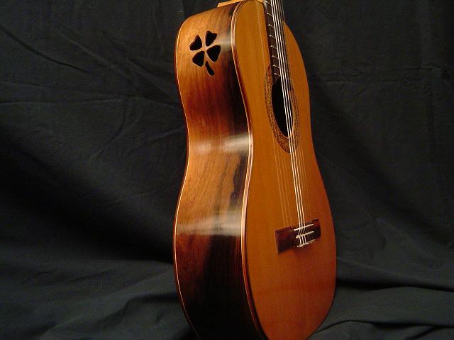

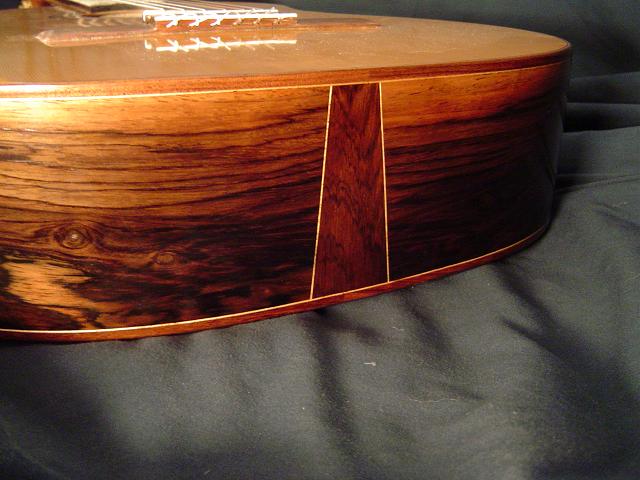

Here are some shots of the BRW classical I recently mentioned I was finishing up. Top is WRC and finish is French Polish. Back and sides are BRW. Neck and interior braces are Cedro Rosa from Brazil. Bracing pattern is my version of a nine fan Fleta design. ENJOY!
PostPosted: Tue Nov 29, 2005 5:42 am
Robbie, that's just awful, you should be ashamed of yourself
Wait, that's just my jelousy speaking, who let you do the typing.
That is truly a masterful piece of art Robbie, the book match on the sides and back are amazing. The side port is wonderful, nice design, I will have to try that sometime.

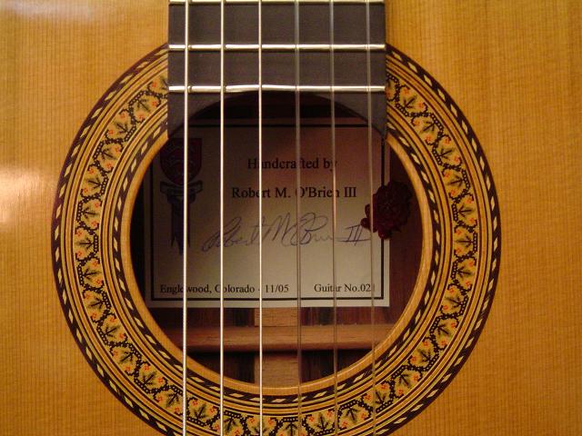

Can you give us a frontal picture please, the rosette looks very nice as well.

Here's a frontal shot and one of the rosette. No, I didn't make it. It is a custom design that I bought from a luthier going out of business in Rio years ago. He got them from Japan. I liked the green, being Irish

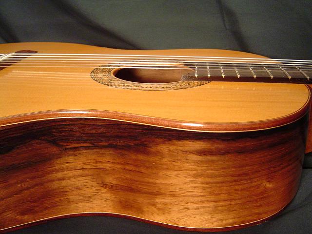

Pretty Zoot for a classical! It has a nice clean, modern look. The shamrock port is a nice touch. Is it just the light in the photos or is there a radius on the binding? If so what radius?

There is a radius on the binding, if you can call it that. I just rounded it over using a scraper and finished it off by hand. A small roundover bit would do the same thing.

That is absolutly stunning work. A beautiful guitar design and wonderful features. But I would check the inside very carefully. I think there is a So. American mouse in there eating away at your label.

hahaha, That is a wax seal with an "O" for O'Brien. I Have heard them all, like "Hey, someone stuck some chewing gum inside your guitar"
